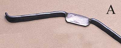

Drawknives and spokeshaves are among the tools I use for neck shaping (and other carving tasks). My favorite drawknife is a little one I got from Japan Woodworker. The smallest one they sell - it's called the "straight micro drawknife" from North Bay Forge. I love this tool. I also use a really nice handmade carving knife my wife got me for Christmas, in the heel area and the transition to the peghead. I also use rasps. On my next necks, though, I'm going to try doing a lot of it on the belt sander. Not the old world craftsman way, I know! But I know some builders do most of it on a belt sander really fast and I figure I'll give that a try.

Here's a pic of this awesome little drawknife, taken from the Japan Woodworker web site. The blade is maybe an inch and a half long.
